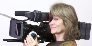

I have always used the IDX batteries, I like them because they are stackable:
So you can balance a rig like above.
But I have now started using the Swits as well they are very nice and a bit less pricey, they also have a D-tap right in the battery. I am starting to sell these at my website. If you need them right now contact me direct. We are putting them up on the store this week.
