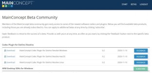

On the other hand, if you are using Resolve 17 MainConcept has a Beta test pack of codecs that might handle the codec within Resolve. You would have to sign up and register as a Beta tester with MainConcept to test this out. You can do that here.
https://portal.mainconcept.com/login
I haven't moved up to Resolve 17 yet, still on 16. I prefer to use full releases that are well settled. Spent too long as a Beta tester on other NLE software. :)
Once registered you can download the Beta codec pack. I think it should work. I base this assumption on the fact that I use MainConcept's "Total Code Studio" which so far has decoded all A7Siii XAVC clips I have thrown at it including its new XAVC HS HEVC codec. A codec whose DNA I have never seen before.
