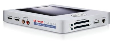

Manny moons ago Cineform was planning to make a Cineform based recorder.
Somehow David decided to ditch the project. That´s a real shame, cause it would now now (several years later)
be probably selling like hot cake.
