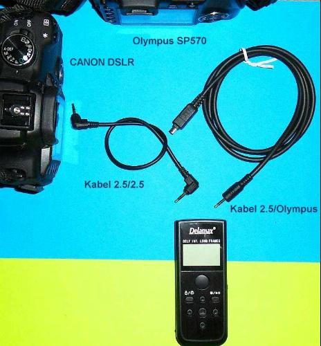

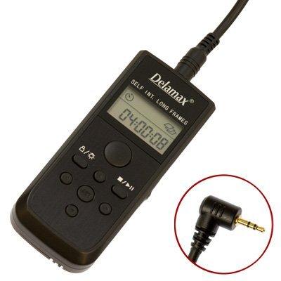

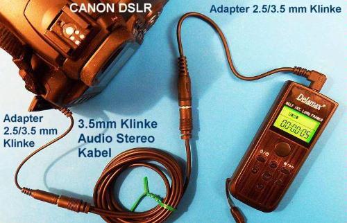

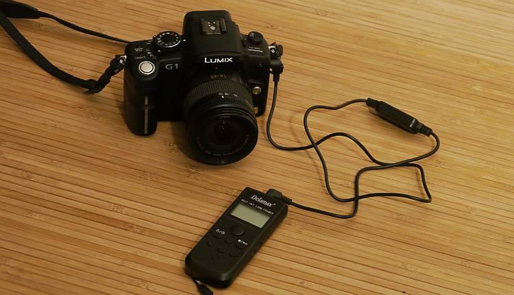

I'm using a Delamax timer - it's cheaper (-20%) than JJC, but has same functions. Aaaaaand it has NO FIXED cable, you can use it with EVERY camera - Canon, Nikon, Olympus, Panasonic ... only change cable with connector.
Of course it works well with G1 and GH1
Same remote you get under the name "Phottix" ---> enjoyyourcamera - but € 30 more expensive :-(
verzögerte Auslösung: 1s - 99h 59min 59s
Langzeitbelichtung bis 99h 59min 59s
Intervall: 0s - 99h 59min 59s im Sekundentakt
Serienaufnahmen: 1-99

Delamax timer (Phottix timer is the same!) has 99 (!) frames limit - but how upshot said,
if you set interval timer to 2 sec and frames to 0 then it makes all two seconds a picture till you end the process.
intervals: 0s - 99h 59min 59s !!!
If you set interval to 65 sec and frames to 10, then it makes 10 pictures, all 65 sec one.
If you set interval to 24h and frames to 7, it makes each day 1 picture - one week long :-))))

they heve them on amazon.de.
i'm not sure which connector is needed though. from the above picture looks like the canon one will do. JJc is sold out as is Phottix in UK.
