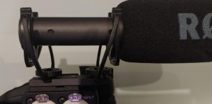

@JMONE My Rycote mic mounts finally turned up so I was able to test your 3d printed thumbscrew mic mount part you so kindly sent me. All works and mounts with ease. Only issue is I guess with the Rycote part itself and that with a Rode NTG2, which is a fairly typical shotgun length and weight it gets a bit bouncy and on occasion the mount bottomed out. Probably only a problem doing handheld stuff in the wind and all would be solved with a shorter, lighter mic.
If you ever do a V3 I'd suggest making the space between the 2 mounts longer which would probably alleviate the issue as well. Thanks again.
Thanks for the feedback & Yeah, I found that as well and hence made a couple of lengths but.... the issue with this design is always going to be that nut part takes up a fair bit of space right under the Rycote.... and I've already made it as thin as I think I can do (already a chance of cross threading and stripping). What I did find is that this works well as it forces bottom of the Rycote away from the nut.
What I'm thinking for a 2nd design is a single (and bigger) nut between the two mount points that holds down a plate that secures both Rycotes. Also, if I did make it longer, in what direction (backwards or forwards) as I was concerned that it would become a snag issue if it stuck out any longer than the "long" version.
