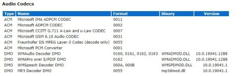

I suspected a missing codec but comparing side by side, line by line, both PCs have the same 10 codecs listed. I tried exporting various WAV and MP3 from Audacity. I even did a 'Record what you hear' on the good PC in an attempt to skirt around anything from the original surviving through the conversion except the sound itself. No luck. I am stumped trying to think of what took a dislike to the AX700 audio tracks all of a sudden. The video is OK. Catalyst Browse barely gives any audio metadata information so there's nothing distinctive revealed there.

Codecs! Don't know which one, don't care. I had the latest K-Lite Codec Pack in my download folder so I went for it. I typically only run those updates when I absolutely have to. I guess I had to. They are such a jumble of excess items I don't need. My needs are pretty plain Jane. Speaking of which I just blasted Jefferson Starship's "Jane" to unwind myself after this frustrating day. Still a great rock classic.
