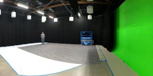

If the grid is at 18' high, how high should the cyc wall(s) be finished? I think I'll lose almost 3 feet to space lights hanging down from the grid.

Finish your cyc as high as you can go - You will constantly kick yourself every time the low camera height and up angle reveals the edge. I found some old documents on a hard drive where I'd ordered paint for the floor in 2001. In the April to April year, the floor had changed colour 6 time. White, black, green.grey and two I couldn't identify. Whatever you plan now gets thwarted by the second client! I think you have a nice space - so if it was me, I'd try to keep things as flexible as you can. My small studio has cloth walls in the main, and I use about 3ft behind it for flight case storage! I have black, white, blue and green cloths and the only one never used, but always left hanging at the back is the blue. White was this years most useful. For your kind of studio a pipe and grid at the highest level is probably the most versatile - you can lift things, attach things and modify it with not too much effort, for reasonable cost - once you check what kind of loads your roof structure can support

I second Paul's most recent post completely with a couple of observations. Your ceiling height at 18 ft could easily become a factor. My ceilings are at 22 ft and I have bumped into that on a number of occasions. Admittedly, I have the Chimera bank hanging (with all the hardware and positioning mechanics) but if the ceilings were lower, then it would lose almost all its flexibility (I wish I had three more feet at minimum). Second, the cyc wall needs to go to the ceiling for sure (up to the hanging point of your lighting grid - which should begin with about 30in of space in front of the cyc wall). This for exactly the reason he states - when you look up with a slightly wider than normal lens you will quickly see the top if it does not go as high as the ceiling.
One more idea on the cyc. Get as much width as you can with the curve across the back wall. Then curve just the vertical inside corners (but not the floor) as you meet either side wall. Yes it will be a strange compound wall on the ground in the corner, but you gain all the floor space back within a few feet that would otherwise be curved out about 15-20 feet. Since the radius is going to vary anyway, make the vertical corners a slightly wider radius going up to the ceiling so they are a bit easier to light. The trick is in the corners themselves as far as finish, but you gain a sense of infinity on the walls and much added space on the floor because the cyc curve tapers very quickly. Just a thought.

The way we are thinking to do the top may actually allow space lights to be attached a bit higher than the grid so they hang down through the grid. That way they don't eat as much of my total height by hanging quite as low? I haven't seen anyone do this yet, and it may not work, but seems like it may be possible. I'm planning on having my permanent space lights, and a few others, and the rest will be changed / attached per project.
I'll plan on finishing the cyc wall(s) all the way up to grid.
Thanks about the 30" distance off the wall to start the lighting grid - I was wondering about that.

One clarification about the grid distance from the cyc wall. Many things come into play and lighting requirements can influence this. In no particular order, because of the cyc curve, a lift may not get you to the lighting instrument closest to the wall, so a ladder may be necessary (and may well be necessary to service anything attached to the top of the cyc or ceiling close to the wall). You need room to climb for install and adjust. The distance from the cyc wall may need to be more than 30 inches depending on how low you pole the lights down towards the floor. Also, if you want to hang a reflector, hang a curtain or position lights directly to the top of the cyc wall (or some other custom mod) you do not want to fight the grid to do so. I have a pulley system that allows me to hang almost anything I want very close to the wall (lights, curtains, backgrounds, etc... - and several suspended dedicated 20A circuits that "float") and place it at any height down to the floor. When not in use, I just pull it to the ceiling out of the way. So, perhaps the grid system might be best starting 48 or more inches off the cyc. How you work, what flexibility you want and how you might reach the ceiling all play a role in this.

I want the ability to slide black curtains around the studio similar to this pic. It appears their grid has some distance from the cyc. I was wondering about being able to reach the fixtures at the walls. 48" sounds doable in my case. Morgan and Paul have shared some input on ladders previously. I won't have an electric lift until I can afford one later. I'd like a lowerable grid system but haven't found one affordable yet
