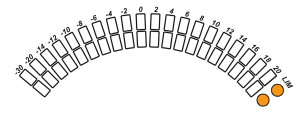

But I'm not sure of that: should I set the gain so that the dialog gets between -18 and -12 db on the meter?

Dialog is recording at the between -18 and -12 (which means transient peaks can hit anywhere from -3 to -6) to ENSURE that peaks NEVER reach 0. Most editors will expect dialog to be recorded at that level. This is the level you adjust the trim control to read on the recording device. The mixer meter reads post fader so that won't help in setting pre-fader levels.

The MIXER'S meters will read between 0 and +4 dB, the RECORDER'S meters will read around -18dBFS.
On my alphamix, the mixer's meter's deflection will change based on how I crank the level control of the channel, which is the level being send to the main outputs, not the channel isos, irrelevant if the iso is being taken pre-fader. So, at least on my alphamix, the mixer's meter will tell me nothing about the level of signal being sent out of the channel direct output. It is my understanding that the 442 is also pre-fader.
That being said, you can use the pfl switch for each channel to view the channel metering, pre-fader. This is the momentary switch labels pfl. But, without the pfl switch being engaged, the mixer's meters will meter the output of the mix, not the individual channel level pre-fader.
So, again, when using the channel outputs, the mixer's meters (unless using the pfl switch), as well as the channels fader knob, are irrelevant to the level being send out of the channel's direct output.
True for the 442 as well. However the 442 does have a momentary contact 'PFL' switch on each channel that sends the post-trim iso signal to the meter left channel and the phones, bypassing the channel faders and main output level control, for gain setup and monitoring.
