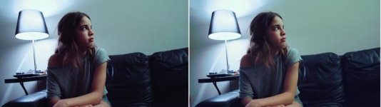

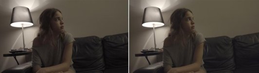

The following images uses ambient light, ISO 2000, Color temperature 3200, Slog-2, 4k->HD ProRes
Left frame of each image below is the AVCHD version and right frame is from Odyssey 7Q.
As you can see, I got a quite visible magenta cast/banding on skin tones (and also on wall) on 7Q footage.
This very noticeable magenta cast is very hard to correct in post.
Graded version with FilmConvert Plug_in (left image is AVCHD and right is from O7Q)
Ungraded version (left image is AVCHD and right is from O7Q)

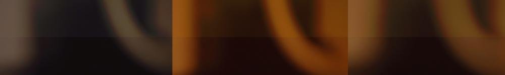

I did this test where the top of the image is the 7q footage and the bottom the internal avchd. Left to right: indoor preset, outdoor preset, manual 4500K.
It clearly shows that nothing has changed. Altough not as extreme, the weird color gradation is also clearly visible in the preset WB footage. Also it is even visble in the VERY flat slog2 profile and as you can see in attamburs image it magnifies a lot when graded to proper contrast / saturation.
