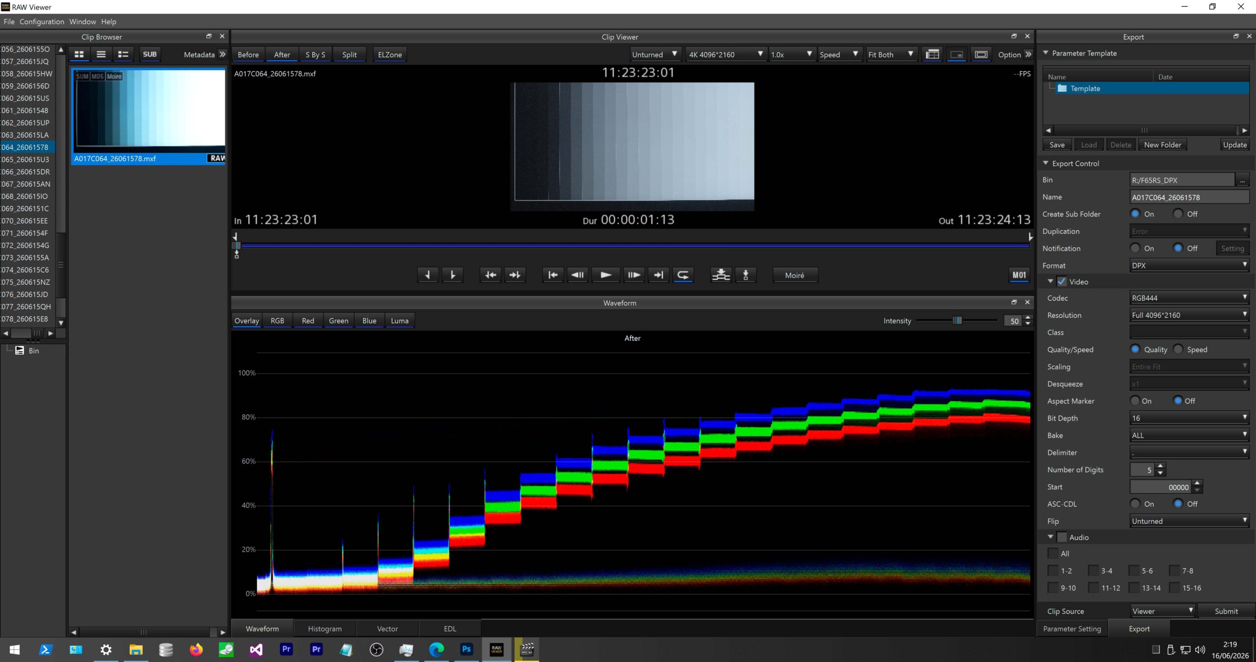

I see, correct me if I am wrong, 16 stops over the noise floor.
I Did many test, to this chart, 25 shots, from T22 up to T1.3, any step was a line (small or big) on the Arri Master prime
To me, on below grab, I see 16 STOPS over noise floor, 17 stops counting the just within noise floor, and 18 stops, but hey be aware that Im not sure at all as the chart was not coloured, just black to white. Fotget the "AFter" tag, its just same as "Before".
But what I know is that the colours aro so goos, se more below
This to me, bewlo, is about 15 Stops
Below at T9 as T22 and T1.3 were not good (remember filmed on night with no more ligth that the TV in front of sensor)
Green channel at T9
16 stops over noise
Green at T.9: down to visible 14-15 stops, this TV altougtjh supports 444, with the NVIDIA Quadro RTX 6000 I was using a display link (usb C to HDMI) so not sure if the picture shown was 422 (as I suspect as camera records in 444, so red green and blue should be equal)
Check the blue
Whats your opinion ?

Hi, look at my videos , for example the Gibson one, thats a lot of DR,. also see the pics on the waveform.
Thats above noise floor, takle note that many people did not realize that, as many tools were not available on those back days.
This grapth shows 16.1 to my eye , or close to, above noise floor (in the Green) and look on the RED, men that close to 17 stops.
also as you may know, green has more info as the original sensor 45 degree, has 25% red, 50% green and 25% blue, A-OUI.SOME (pronounced awesome for many many people, a lot)
