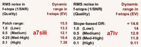

Final observation. CineD is stating 12.9 stops range on the a7iv as opposed to 11.9 stops range on the a7siii. I can't comment directly on that as I haven't had the opportunity to push the a7siii or FX6 to the extremes. All I can say is to date I haven't used any camera under the $5K mark that displays the dynamic range I'm seeing on the a7iv. For a $2500 camera, it's pretty impressive. I may even get a second one. Have to convince 'her indoors' before I take that step though
