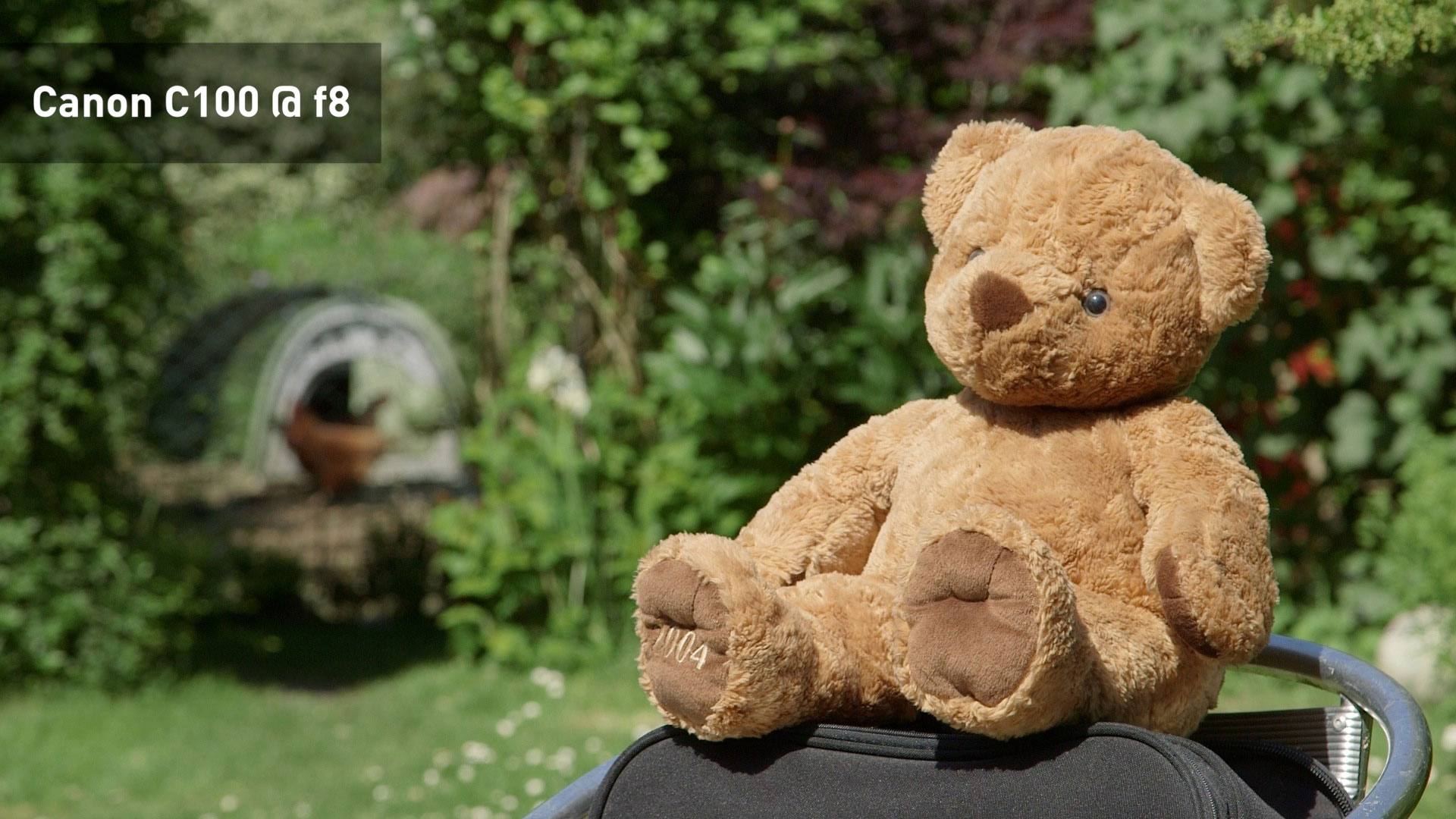

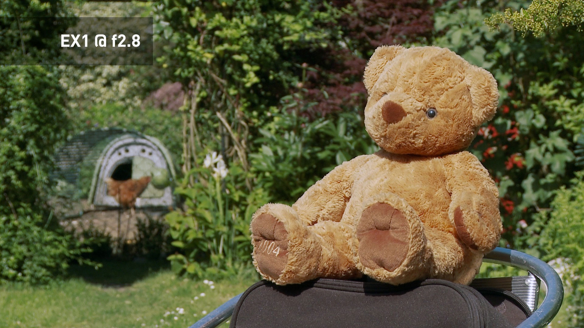

I use both EX1 & C100 (about a 50%/50% split) , and have compared them often - I think you're being just a little harsh on the C100. :) I specifically put the C100 with the 18-135 (and the 24-105) side by side with my EX1R. The DoF at f8-f11 on the C100 matched the f2.8 of the EX1R. And, if you're judicious with the ABB, the image of the C100 is far less noisy. And all lenses benefit from nipping the iris in by a stop or two from wide open. I use my 18-135 at f8.
Yes, the EX1R can be used all day without rigs - as can the C100. After all, the EX1R is probably one of the very few cameras out there with a WORSE EVF than the C100. LOL For me, the choice of taking the EX1R bag or the C100 bag on an assignment is 'will I have time to select the best lens for the job?' Event coverage can be VERY challenging (closeup of presenter, whip back to wide shot of presenter on stage with audience, whip to med-telephoto of a line of the audience, scoot to front for TED style 'up the nose' BCU of presenter - rinse, repeat). OTOH, a day of interviews and B-Roll is the C100 comfort zone.

No offense Matt but i have to disagree with f8 on C100 being same as EX1 wide open. Although u did say f2.8 on EX1.......try f1.9 on EX1 and f5.6 on C100 u might be surprised how close they are ;)
No offense taken - but allow me to post my results in testing the two side by side:
I habitually use 2.8 as the widest aperture on the EX1 as it avoids the 'ramping' of brightness as you zoom, and quite frankly, I find the images lack bite at the wide end at 1.9 - all lenses get better by a little 'nip' from wide open to one or two stops extra.
