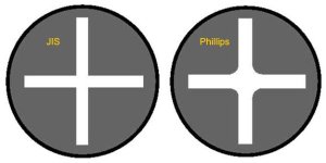

From what I've researched, these are the smallest philips screwdrivers in existence: 0, 00, 000, and 0000. Anybody know which one fits those tiny screws on EF lenses?
Both sets include JIS (Japanese Industrial Standard) screwdrivers in 0, 00, and 000, which just about cover everything on the planet.

I think NorBRo is right: it needs a "Japanese Industrial Standard" screwdriver.
From what I've read online, an JIS screwdriver might work OK for regular Phillips screws, but not always vice versa. Before I got some JIS screwdrivers, I was breaking the tips on small Phillips screwdrivers and damaging the screws on my C100 and EF lenses. This might be why.
