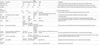

I've made spreadsheets like this in the past for purchase decisions. Not sure if it's a waste of time but if you don't make one when you come back a few months later to re evaluate you can't remember all the reasons why you might want one camera vs another.
