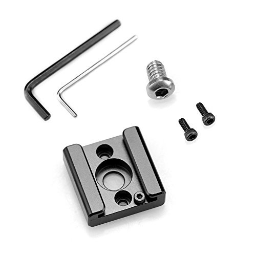

I bought one of these and put it on the top handle of my C100 Mark II. It's very handy!
http://www.amazon.com/gp/product/B00HJFBUCQ?psc=1&redirect=true&ref_=oh_aui_detailpage_o00_s00
