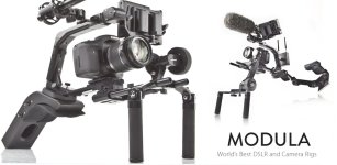

but also consider that.... my self i am not a fan of edelkrone, in fact i hated modula 7 from the beginning and lucky me was able to resell with in 2 months of the purchase (they did not have it in stock and the guy just had to buy it from me), BUT a big BUT - they have at least 2 products that i think is a MUST HAVE!!!!
1. Accessory Connector - its just exactly what u ve been asking for...... perfect in any way, i own 2 , i sold the rig, but left that part to my self!
http://www.edelkrone.com/e-store/22-accessory-connector-kit-8680177980132.html
look at that image - the way the mic is attached:
2. Monitor/EVF Holder - another perfect tool! - a must have, it really works!
http://www.edelkrone.com/e-store/37-monitor-evf-holder-8680177980071.html
