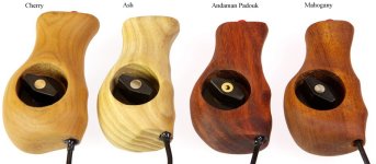

Is anyone a fan of wooden grips? I've never seen the attraction - they just look wrong and out of place to me! ;)
Wooden handle grips are classic. Film cameras used them for years and still do. Wood is a fantastic material, comfortable to handle unlike plastic or foam even, it can easily be customized to your hand and will age beautifully with just a light oil finish.
I have made hundred of wooden handles and I may start making them again. I am working on new designs for any camera, very adjustable aimed at the A7, G4 size cams, but also usable for larger cameras. I will use wood where it makes sense.
I get a lot of requests for custom wooden handles and I make them as orders come in. Wood is a wonderful organic material, the perfect carbon fibre really.

Here is a photo of my AF100 handles, they were my production handles, I still have some in stock and sell one once in a while.
The switch is specific to the Pany, so it does not work with other cams.
I basically made small, med and large versions, each is hand carved. These are $325.00 with the rosettes and body mount. But I encourage users to sand carve or whatever method you like to customize to your hand. Most users just use them as they come. I made a few custom fitted right here in my shop for visiting shooters.
The AF100 is not a very popular cam any more, you may know why, I won't go into it here. I used mine for over a year and got great footage from it. These days there are better solutions so I have moved on.
I make parts for the cameras I use, and a few others I know are good, or by special request. The 700 handle is really pretty good and has a lot of functions, so I never made a replacement for it myself and I only had a couple requests, so I saw no market for the wooden handles for the 700.
Now the new crop of small cams will definitely need handles, so I will be making them again.
