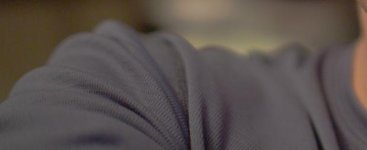

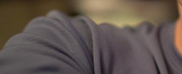

Would you mind posting those A/B frame grabs?
ACR
Resolve 10
Uncompressed PNGs:
http://www.brightland.com/t/ACR1.png
http://www.brightland.com/t/R10.png
[EDIT: was able to improve microcontrast with different settings to closely match ACR in detail: the parts of the shirt pattern that were completely disappearing in Resolve are now showing up]
Overall colors are also a challenge with R10- easy with ACR. Too bad R10 can't match ACR as it is so much faster (~18fps vs 1-3fps on 4-core laptop).
Note also that ACR can do lens corrections (which I was testing in this example- the ACR frame is undistorted (slight shift if you A/B the PNG's with Photoshop layers, browser tabs, etc.).
I think you are misinterpreting contrast as being sharper. There is no difference in "real detail" between those shots. Resolve shot looks quite natural.
Microcontrast is detail- many parts of the shirt pattern disappear into mush with Resolve. If you A/B the uncompressed PNGs by opening both you can toggle browser tabs (and zoom in) and the difference is more clear. Playing back real-time Resolve was clearly lower detail.
