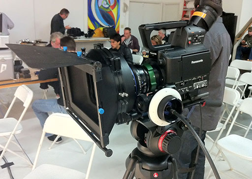

@Boon
Yes there is up down and left right adjustment on the plate. For the AF100 there is no need because the baseplate fits perfectly. Just returned from a Panasonic AF100 event and you can see the setup
Also as a bonus the microMatteBox plus the microSupport baseplate also fits the Panasonic 3DA1 camera quite nicely as well. Barry, yes it's a full size cinema mattebox, and sometimes that's a good advantage!
brian, that is beautiful! thanks for the photo.
is that the V3 FF on the rig? any word or still the same?
also wondering what size rods you used, i am still on the long shoulder/encore rig rods and would need some shorter. thanks!
