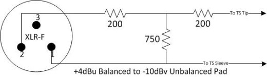

Is there an off the shelf line level attenuator I can buy? Is that the right way to go?

You can convert by insterting an inline pad in each leg of the output. Because of the different 0 reference voltages of the two units, -10dBv is equivalent to approximately -7.75dBu. You need approximately 12dB of attenuation to knock the +4dBu studio line level down to the -10dBv consumer line level. A -10 or -15 dB inline pad would be close enough or you can make your own by putting a simple resister network in each XLR plug.
