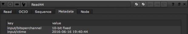

Does this look right to you guys; cam set to 444 12bit, Odyssey set to prores444. Nuke metadata is showing the file as 10bit:

The issue is with Resolve, not the Odyssey. The Odyssey records everything right up to 109% (and down to -7%) but when Resolve decodes ProRes4444 (and XQ) it clamps at 100%. Resolve also adds extra confusion by treating the clip ranges of ProRes4444 differently to other ProRes variants. With "data" selected it maps the 0 to 100% to it's internal 0-1 range. For other ProRes formats "data" maps -7 to 109% to 0-1.
It is a problem with ProRes4444. Many applications "assume" ProRes444 contains only RGB data in the 0 to 100% range, and clamps to that. Adobe applications also do so. You can see the entire range of the data in a ProRes4444 file if you open it in ScopeBox, for example. Nuke can also read it, although not with the default Read node settings (you need to choose the mov32 decoder and a YCbCr pixel format). Baselight can also do so.
