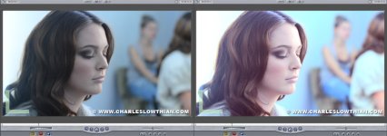

Updated (screen grabs):

Wow love that look ...was that colorgraded or did you do it incamera. Not the BW stuff btw.

Thank you Everts! Color corrected in FCP. Upped the mid tones, whites, and saturation.

Amazing footage, I just got the D3100 with a 35mm/1.8 - I'm looking forward to playing with it further, trying to get results like yours! I don't suppose you know of a free and Windows-based method for similar color correction? The difference is dramatic!

Thank you!
I haven't used windows in a very long time for video editing, so do not know what's available. If you can adjust the mid tones, whites, and blacks; then there is a lot that can be done to the color.
