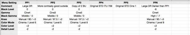

Here are the PP's I use with comments. This is before I started using 4K->HD ProRes Slog2 Odyssey.
#2 and #3 are the same and the ones I use 90% of the time...
