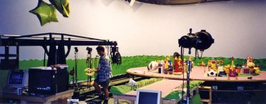

Don't be such a tad wad, Matt. Get yourself a Motion Control rig. You know you want one. You deserve it.
On the other hand, you'll need a sense of humour, asbestos fingers and a soldering iron...
Here are some pics from series I cut back in 1999 at Pinewood with the Star Wars model team. The rig broke down almost daily, causing the AC to weep regularly. We shot it on 35mm with a periscope lens:
Funny in hind sight, but she was a monster to live with...

That... is so... awesome! LOL
