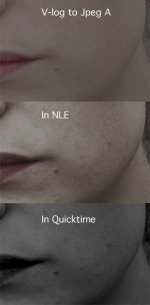

There is a simple methode to check for the Chroma smearing, inspired by what Lpowell wrote:
http://www.dvxuser.com/V6/showthrea...-LOG-L&p=1986578386&viewfull=1#post1986578386
http://www.dvxuser.com/V6/showthrea...-LOG-L&p=1986578534&viewfull=1#post1986578534
…Use a YUV based codec to check your footage
-Open your footage in Mpeg Streamclip.
-Export to Quicktime.
-Apple Component Video YUV-422/Apple Motion Jpeg A. Both operate in YUV space. Jpeg A slightly less accurate but a third in size.
-Make movie.
Open the resulting clip in Quicktime and adjust Brightness and Contrast with help of the A/V controls. You can even desaturate the clip.
Even if the problem it is not related to Chroma smearing a YUV codec does a great job showing what most of us experience as the problem …even when recorded in 10 bit.
