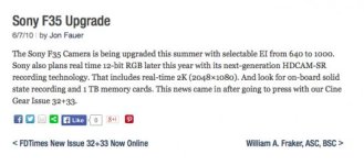

A few posts back got me sifting through the FDtimes archive. It refers to a 2k format for the F35. Are there any recorders that can do this? There isn't even a way to set the camera I'm assuming. Anyone ever get to use the codex recorder?
Well with on-board solid state recording ditched, I'd doubt there was an upgrade for 2K. Esp. when the sensor was specifically designed for 1080p? Besides upscaling F35 materials to 2K shouldn't be a hard task isn't it?
The onboard SR recording would have been the Sony SR-R3, essentially the Sony SR-R1 with the F35 docking kit and it's own firmware. It would have fallen between the SR-R1 and the SR-R4.
Mind you, excluding the 2k, ramping, and select FPS, most of this is still possible with the SR-R1.
