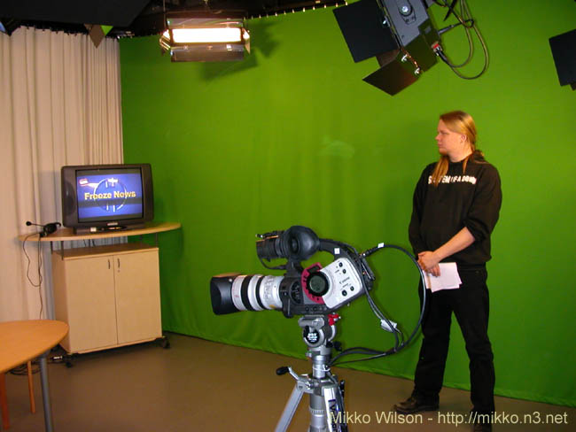

I went to the BIRTV show here in China this week (Chinese NAB) and saw a really fabulous green screen fabric (from Thailand) there that was one of the type that have the thin foam backing.
Those are really great if you can find those reasonably because they don't wrinkle. The foam keeps them very nice. In addition, the surface was very much like a felt type material with absolutely no shininess to it at all so it shouldn't contribute too badly to green spill--although they will all have some and you still need to keep the talent as far away from the screen as possible.
I just bought a green screen from Amvona on eb*y for $54 plus shipping. That's a 10'x12' screen. They also offer a 10x20 for $66. Granted, these are cotton dyed, not polyester, so it is a little lower grade., No lower than the IKEA stuff, which remember is $2.99 a yard, so thats 54 inches by 36 inches.

I have the Amvona 10x20, it was the first one I got and I agree about this but my next screen will be one of these foam backed polyester types with absolutely no sheen at all. I'll spend more money next time because its worth it to not have to mess with the keying which takes longer when the screen is substandard.
I´m always amazed what some people on the net pull off with DIY greenscreens, painted cardboards with inconsistent green lit by hrd worklights aso - in the end it seems to depend on the skills of the compositing artist...
