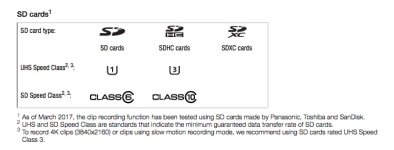

Chances are you are using incompatible cards with the camera, not that the camera is broken, although, of course, that is possible. All Canon says in the manual is to use UHS1 or UHS3 cards, but they do say as of March 2017, the camera has only been tested and proven with Toshiba, Sandisk and Panasonic cards.
The simple test is to buy or borrow another brand of card. If the other cards work flawlessly with your camera, it is obviously your cards are incompatible with the C200. If one or two other brands exhibit the same inconsistencies, then perhaps something is wrong with the camera?
FWIW, I have been using my old Transcend UHS3 Class 10 64GB cards from my C100 MKI in my C200 and they have been flawless so far and I have shot some long interviews with them already, 90 minutes onto two cards the other day. No issues, no time to write after stopping.
