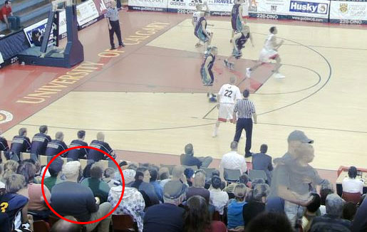

And here's the partial exposure:
I wonder what flash unit that is? That's a lot of light when you compare to the normally exposed parts of the frame!
It's also kind of cool to see how much faster the flash "lights up" in the first frame in comparrison to the "fade out" in the 2nd frame.

It looks like multiple units slaved together .. the shaows of the ref. and the hoop come from the other wall.
Probabaly the stobes of a professional photographer who has powerfull pods triggerd via radio from his camera to light up the place when he wants to snap a fast shutter pic. Not uncommon at all.
- Mikko
Oh that's a flash for sure. That's exactly what a "partial exposure" of a rolling shutter looks like.
If you look carefully, you can tell by the shadows that the flash came from the left of the EX1...
- Mikko
Good eye, Mikko, I missed that shadow. Yup, guess it is a flash. I've never seen a frame with camera flash look posterized like that. It threw me off.
The first sentence was my first thought as well, and it seems strange that it is as intense in the foreground as the distance?
If those are consecutive frames, then the assumption mikko makes above seems to imply that it lasts exactly one frame, if we are indeed seeing the beginning and end of it. So 1/60 second? In which case, surely that's far longer than any normal electronic strobe?
I'm also curious to know what that video is like at normal speed.
I don't know guys. I hate to say it, but something about this looks odd. From what I know, when pro photographers set up strobes for basketball, they mount them to the catwalks directly above the court at the four corners and point them down towards the court. They usually don't mount them to the side like the way the shadow is showing because it would bug the hell out of the people on the other side of the bleachers facing the strobes. These are very powerful studio strobes, not consumer camera flashes, so they're pretty blinding.
I also tested partial exposure on my HV10 and at least on that camera you don't get the fade out like that. It's a very sharp line between the flash and no flash.
Of course, I could be wrong. Who knows?! We need more EX1 shooters to go to NBA games and check this out.
EDIT: I take it back, sometimes they do cross light from the bleachers. This was a college game so they probably don't have a lighting grid or catwalks on top. Cross lighting is not permitted at a televised game (NBA or NCAA) because it would interfere with the TV coverage.
