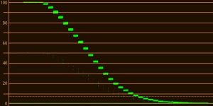

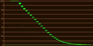

@gonzo_entertainment: I usually talk about DR in absolute terms (i.e. what is different from clipped black), since "usable" (i.e. what is not so noisy that you'd rather clip it) is a very subjective matter; even so, 7 or 8 stops seems really low to me, you must really hate noise-in-the-shadows!! Even "portrait with contrast=-1" has 8.5 stops
and Prolost Flat ("neutral with contrast=-4") has 9:
This video shows a couple of the things I was talking about: https://vimeo.com/39899742 That's the D800 with Flaat_13p, which delivers 12.7 stops of DR. Is that usable? Well, actually I'd say it's not: that heavily posterized noise in the shadows is absolutely horrible. But, as you'll also see there, if you're not afraid of applying heavy noise-reduction, and need as much DR as you can get for a very specific shot, well, you may consider it an option. Also, the still taken with the same picture style is absolutely clean: as with the canons, it's not the sensor, but the in-camera image processing that's limiting the DR you get in video mode.
