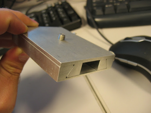

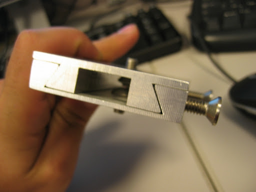

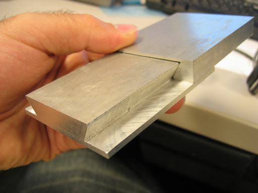

I went into more detail over at HBS, but that's about it. Now I am going back and modifying the system...starting with my camera quick release bracket shown below.
