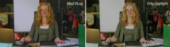

Sorry to say, but I don't like the GHa for now. On first sight it looks to work and it does straighten out the collors. But when I compaired it to the Mlut for VLog the colors from the GHa LUT seemed very crooked.
I white balanced the shot on booth images and just applyed the LUT in lumetri on both the same. I am going to do some more tests. The lamps used in the shot are 5200K. It does not give more DR but beats the highlights down.
Everything seems very green compaired to the Mlut.

The skin tone region of the original GHa is a bit shifted to yellow (incorrectly), and the Varicam LUT distinctly towards magenta.
Something critical - thanks to the tireless efforts of David L'Abbée, I recently discovered that Premiere is shifting VLog towards green, to a significant degree. This doesn't happen in DaVinci Resolve, and is a complete surprise to me. Also, the Luma curve of Lumetri shifts color incorrectly; use RGB Curves in the Obsolete folder instead (LGG wheels of Lumetri are fine)
I am working on a fix for the Premiere shift that will be part of the next larger update. There will be a Premiere set, and a set for everything else (another [PRE] may be tedious)
Wow, I am supprised Premiere does that. Very unfortunate. But I played around a little bit with the levels and got pleasing results imho. Especialy turning down the sat from the yellow and green a bit did good.
