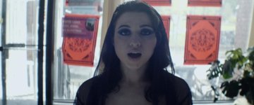

I would assume SAGE's LUT requires a correct exposure for the LUT's rolloff to operate correctly. Under or overexposed video would seem to require an adjustment first.
See how details get lost in a before and after comparison (due to a too the high exposure)
Ryan, could you share a unaltered dpx or a 10 bit tiff of that frame?
Well, there is highlight compression and highlight compression.
I think if you carefully make a shoulder to roll off the highlights then that can look great, however, compressing all the highlights into some high mid-tone mud is obviously not, at least not in my view.
Sure thing. I hope you'll give me the benefit of the doubt on this one; I did take a great deal of care to set the shoulder for the intense highlight range
Many do prefer a higher ceiling, and Linear is a better starting point in that case
This is a shot that obviously is pushing the GH5s to the extreme. Sunny, blown out window, only a touch of bounce for fill, hazy, low-con look from the Classic Soft +1 filter and a big blue flare from the vintage lens right on her face.
The highlights are sitting at 768, where the LUT put them.
Vlog from camera:
V2 Soft:
Final:
Hey Ryan, how did you handle/do the light switch moment, when it goes from warm to cool? That was pretty neat. Did you swap conversions at that point?
No doubt, the shot was obviously overexposed (I understand why, although I would have over exposed a little less) so the LUT can't be blamed. No-one can expect a LUT to work as designed if the exposure is not correct.
A LUT that does a highlight roll-off must expect a proper exposure, so in this case, if an exposure adjustment node before the LUT is applied was added that issue should go away.
Sure, here's a DPX: https://we.tl/t-kwDN5lFc2P - Was shot internally at 150Mpbs 4:3 and transcoded to ProRes422 (DPX is 1080p)
Also, here's what the shot looks like developed with FilmConvert (and slight exposure drop) instead for reference:

Yes, that shot is very challenging. The highlights are completely blown out.
You could get some more color out of it:
Or a bit colder and more contrasty:
The plan was always to blow out the window, since what was happening outside was decidedly not in keeping with the near-future setting of the video's story. So I overexposed all the shots with the window in the BG. Normally, I would've let her go a bit darker to save a bit more of the highlights.
I really like the way the GH5a LUT rolls off even in a messy shot like this. A bit of detail is lost but the transitions between different brightnesses near clipping look much smoother/pleasing to me.
The low-con desat-ed graded is obviously a taste thing, but I think how it ended up suits the rest of the video well enough.
