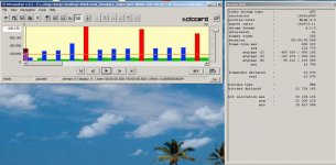

Thanks for that link, AKED. First samples of 24P footage!
It appears that optyczne testers were quite aware of GH1's woes and did a fast pan on death foliage with high shutter speed. Yeah, beauty comes mainly from what's not there -- namely any significant amount of mud. Avd. clip bitrate is ~22Mbps, with max 28Mbps. Not too bad, as we have B-frames. And did I mention the "proper" framerate of 23.976 instead of GH1's 23.971 (in native mode)? Boy, this would be sweet when hacked to ~50 Mbps ... :)

I have posted the release version of StreamParser 2.0. The main addition is support for other cameras. When an unknown camera is detected the video frames will show as gray bars. In the configuration>camera menu item it shows which camera type was detected. I have put every model I've had access to in there. If you have another Panasonic camera model that looks like it was correctly detected please let me know so I can add that model to the menu line.
Also, if there is a Panasonic AVCHD camera that was not detected let me know (and supply a very short clip from it, if you can).
You can get it here: http://www.dvxuser.com/V6/showthrea...ta-Available&p=2113515&viewfull=1#post2113515.
