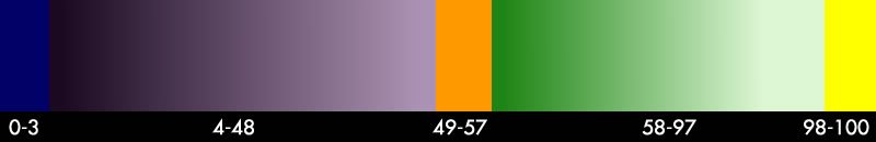

4- above is the color chart for the false colors. The numbers are the %age of light. 0% is complete black and 100% is clopping overexposed to saturation.
basically, everything that is blue will be black/very dark (but doesn't necessary means the information is lost. purple is the dark areas, orange is average (also slightly higher than skin tone) green is light white is high light and yellow you are too close to clipping.
What you want to properly expose your image, make sure nothing except light bulbs are overexposed (yellow), then look at the faces, you should see a bit of orange in it and the rest mainly light purple. Then make sure that the rest of the scene is not too dark in the blue section.
Hope it helps.

I can confirm that the 2.35:1 guides are accurate. At least they match the 2.35:1 matte in FCP. As far as "negatives", most of them have been fixed with firmware upgrades. The yellow cast is gone if you have a recent firmware upgrade. The new version of Focus Assist is much more usable. But the false color mode is what makes it great. It has made my exposure spot on, and I can easily tell if something is clipping or buried in the shadows.
