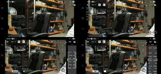

Sorry MM. One correction.
You say the FX6 is HD only with PZ lenses. That is incorrect as you have the full frame 28-135 mm F4 with servo zoom and stabilisation. And if you are on a boom I doubt that shallow DOF and F/2.8 is a major prerequisite.
And I have to ask why you need all the FIZ motors etc?
If you have Sony's wider FE PZ 16-35mm f/4 G and Sony's FE 28-135mm f/4 G PZ OSS you can control everything from your jib handle with touch control using either a long hardwired USB-C Hi-Speed data cable to the camera. Or control wirelessly, totally cable free, if you want. Your choice. Servo zoom can be controlled far more accurately and smoothly using a decent quality servo zoom controller that can plug into the FX6's second LANC port on its back end. I have the German BeBob and Fotga LANC controllers that work very well. With the Fotga I can also control the iris via a rotary control wheel on its controller, if so desired.
All you need for the FX6 is a free download from Sony. It's Sony's Monitor and Control App. It's free from the Play or App store. You can run Monitor and Control App on almost any late model Android or Apple phone or tablet, or iPad. Using a tablet or iPad or large phone this can then become a vision monitor with full touch control of the FX6. If you are using the USB-C tethering method on a long shoot it's nice that it keeps your phone or tablet charged.
Running the FX6 this way I can concentrate on jib movement and zoom framing while an assistant can control Iris and Focus. In most cases I leave the camera on Full AF if operating one out. Allowing me to concentrate on adjusting iris, framing and zoom. If you want to check the last take, you can also do that from the App. You just switch to Thumbnail mode and any clip on either card is available for playback.
Below is a composite image of four screenshots off my Samsung phone as an example. Top left is clear screen, top right is the full info screen. Bottom left is the Iris control screen and bottom right is the Focus control screen. All your touch / tracking / response speed and transition controls are also all available. All your additional tools / aides like false color, WFM, Vector etc. etc are switchable on/off and moveable for suitable screen position. Plus stop / start functions of course.
This just makes the FX6 so simple and fast to set up and run remotely with minimal added 'junk' and cables on the camera. What's not like about it? I have nothing against FIZ motors. I have a full set of PD Air FIZ wireless motors, for when I need them on a purely manual lens.
