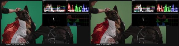

I've not found that to be the case... I shot this 1 stop over-exposed, recorded to UHD ProRes... and no color adjustments beyond lift/gamma/gain using the appropriate Convergent/Nick Shaw LUT in Resolve...

This is the issue I've been trying to address for a while. Take a look at the thread I started a while back (link below)...you'll see myself and Jon Betz have come up with LUTS that do improve the colour inaccuracies of SLOG2 in the FS700 (look further into the thread for LUTS you can download - the last ones from Jon Betz I think are the best). They're not perfect, but they are definitely more accurate than many other SLOG2 LUTs, when it comes to colour accuracy across ALL colours. I'm still hoping to improve further.
