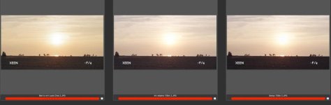

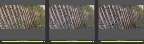

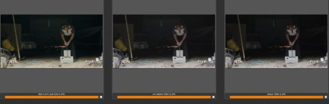

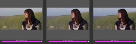

Using my lens test video below, this is what I found with his new LUT. I took Bert's LUT, Art Adams 709A (new), and Sony's 709A for comparison. As you might know already, Art's LUT is very similar to the original Sony version, just a tweak in contrast and levels.
Comparisons below and full resolution screenshots available at https://www.dropbox.com/sh/hpk1ftehg0tekcj/AABicaqWxCAVjC872jqAW_Cca?dl=0
https://vimeo.com/139046904

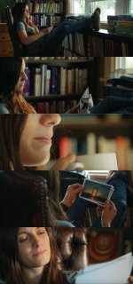

Here’s a few frame grabs from an MV that I shot recently, applied with BertLUT. I adjust the contrast a bit and added some saturation, but no color tweaks. I love this LUT.
Link to full-sized grabs
http://www.builtbyugene.com/images_client/Skin2.jpg
