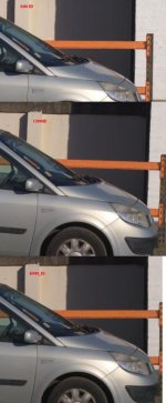

I just did a little test on CineEI.
Camera recording Slog3
EVF, LUT800
Zebras at 90%
Exposure set by having a small amount of zebra on the front wing of the car and different EI values.
For 4000 I had to engage full ND, the first a just different stops on 1/4 ND.
Plonk them into CatBrowse and we see three virtually identical images in colour and tone apart from the noise floor on the 4000 is obviously worse.
Investigating recovering the highlights (not seen here) as expected the 500EI file has less to 'get back' (but suprisingly most of the wing could be recovered).
This would appear to stand up my theories on exposure using luts etc to get a clean file.
Full file here.. It is a jpg 12 so would add marginal compression artifacts.
https://dl.dropboxusercontent.com/u/33167160/ei.jpg

Taking the files into Resolve which I may screen cap later as expected we can see the three exposures. 'Matching' the three images is trivial using the log wheels, but the EI meta data is lost (as expected)
S
This looks as there is a consistent remapping of the exosure values with LUTs
even with different EI values.
If this is true, exposing is much easier as expected.

Also, note how the highlights are best in EI4000 and the shadows best at EI500. That's exactly how I'd expect it to be.
I did a similar test yesterday but the weather is just shades of grey so I had trouble finding a good highlight.
Even with the terrible light conditions it was pretty clear that if you want shadows lower your EI (I shot EI800) and if you want more highlight room then incease EI (I shot EI4000). Its pretty clear why Sony settled on EI2000 as a good middle ground.
