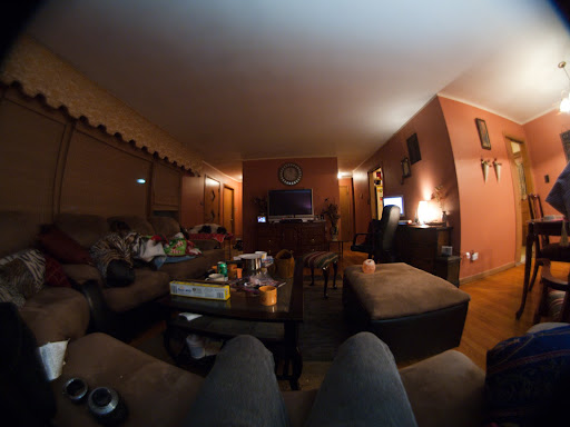

It fits my E-P1 like a glove to a hand! I calibrated it for infinity focus with Nikon lenses (actually, it goes past infinity, but only slightly). Image quality is *MUCH* better than before. No blur, no tilt/shift effects, no stray light pollution. Lens speed is increased, and it's pretty sharp for what it is, although contrast is slightly decreased. Here's a test I did last night... it was shot at ISO800 to avoid blur from my handshake, but I'll have some low-ISO shots soon for you guys:
ROKINON FISHEYE 8/3.5 NO REDUCER:​
OLYMPUS E-P1, F3.5, P MODE, -1.7 EV, ISO 800, 1/13 sec ​
ROKINON FISHEYE 8/3.5 WITH 0.6x REDUCER:​
The vignetting seen above is not from the reducer but the lens. The fisheye lens is DX format, made for Nikon's APS-C, so it creates a smaller circle than a lens designed for a full-frame would. If you remember from my previous post, there was a dark edge around the frame caused by the lens hood; I shaved off the hood to get more coverage for this test.
Here is a vignette test for this fisheye with the reducer: http://img822.imageshack.us/img822/5453/ep1reducerfisheyevignet.jpg
And here is a test with the same lens on full-frame (Canon 5D) and APS-H (Canon 1D) cameras: http://www.360pano.de/en/samyang_5D_1D.html
As you can see, the lens coverage with the 0.6x reducer is somewhere between APS-C and Canon's APS-H. This means that some of Nikon's DX lenses will vignette with this reducer.
