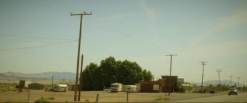

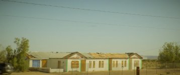

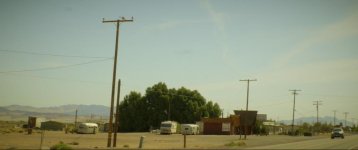

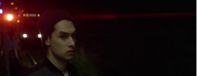

I'm definitely not talking about barrel distortion, but the whole image skewed to one angle. This shot below for example is the most obvious one to me. I've added perfectly vertical lines for illustration. At the start of the pan, it seems like maybe the poles are just at an angle naturally because they are leaning in the ground, but as the shot continues to pan you can see that the building is also slanting to the right, and the car appears to be slanted to the right as well. It's not barrel distortion at the outer edges of the frame, but the entirety of the shot slanted to the right.

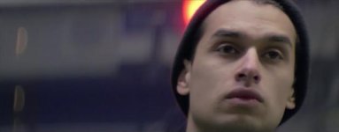

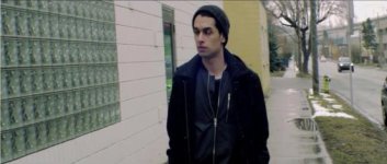

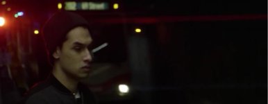

Another pretty extreme example from this video, this looks pretty obviously skewed to the left:
And this one to the right:
This one to the left:
Sorry for my mess of images and attachments, don't quite understand the image embed on this board.

In my limited experience with anamorphic lenses, I've only seen that caused by a misaligned lens, meaning it is not seated perfectly with the top of the lens at the top and the bottom perfectly at the bottom. It's been rotated slightly for one reason or another. Another tell tale symptom of this is that the horizontal flare is not parallel to the top and bottom edge of the frame, which you can see in the pic you posted with the red flare.
the reason you see it so often is because people who use adapters or a 2x projection lens are often eyeballing the alignment and not realizing it's off. with 2x you really have to nail it or you get skew. can't be rotated even slightly.
I thought it might be something like that Zak, it's what makes the most sense to me, but also seemed like it would be too simple to be the sole cause (though I suppose most of these example videos are people's first experience using anamorphic so it would make sense to be an oversight). The only reason I brought it up is because it stood out to me, and since the GH4 is getting better support I was looking at my options for shooting anamorphic and noticed, and wanted to be sure if it was simply a known limitation people have to deal with, or if it was user error or something similar that could be prevented.
To prevent a misalignment, I keep an LED flashlight in my lens case and use it to flare the lens when I'm seating the anamorphic lens to make sure it's perfectly perpendicular to the floor.

If you are shooting anamorphic on the GH4, you need to level the adapter. Change your display view to show the level plane lines on your LCD. Then take your phone and turn on the flashlight. Position it just in front of the lens and point it straight down the barrel. The resultant flare needs to be perfectly in-line with the level guide lines. Rotate/adjust the adapter until they do. Poof you're aligned.
