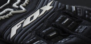

After using older Contax Zeiss lens on our GH4 for the past few weeks we have chosen to go the M43 route and pick up some native glass so we can have AF and smaller weight when needed. I have never used any AF lens on a M43 camera before but after reading all the good things on them, I said heck its time to pick some up for filming this year. I really like the 12-40 and now word of the 40-150 is really making me happy and the 300 will be great for wildlife and surfing, but our first lens is the Lumix 20mm 1.7 that I picked up this weekend for $250 after reading some good things on it. I dont know if its me but I really dont like this one. Its AF is really really slow compared to what I have seen the other lens do and its not that sharp really, its good but but not great. Also I dont know if Im messing up or just wont but the GH4 will not track on AFS, Like I have to repress the shutter to get it refocus on something. Here are some photos, mabye Im just to picky. The top two are the 20mm and the other is the Zeiss I focus by hand.

I'm sorry to say but the 20mm was probably the worst lens to chose to introduce yourself to m4/3 AF lenses. It has always been known to be a pig at AF but people love it because of its sharp image. the first two images seem to be shot wide open and the third is not so shallow?
