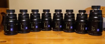

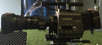

So, about a month ago I got two Sony F23 cameras... shortly thereafter bought a Odyssey 7Q+, and yesterday I finally got glass. Hope to do some sharing here soon.
My testing in the past 24 hours has been very limited - but I'm already finding the 4:4:4 DPX files to be incredible.
Well THAT sure looks like one fine situation you got goin' there!

Does the F22 send out 12bit or 10bit 4:4:4 into the Odyssey 7Q?
Thanks,
M
10bit 4:4:4 appears to be the max. I'm suspecting the hardware may be 12bit capable, but that demand fell off and Sony never prioritized offering such in a firmware upgrade. Sony only had 10bit recorders for it, so there was little push for 12bit output.
That said, the 10bit works great, and clearly was used on both large and small screen productions that are household names.
Beautiful Lenses. I've already used my F23 on 3 projects since I purchased it, mostly for projects where the above stabilized lens can beat out lens options on 35mm format.
Have you updated your firmware? I found an interesting flaw in the old firmware, the 7Q would not see the 30P correctly, i think it is firmware at least, my F35 does not have the same 30P issue. I waited to update firmware after I had tested the camera for a few shoots.
Yes I posted incorrectly the F23 was 12 -bit capable. I am loving the 60P of the F23.

It's only 10bit, but honestly, it's incredible. I think I'm actually more excited about the F23 than I was or am about the F35.
you can tell if the firmware was updated if it has cine-ei mode. If you older firmware, try the 30P or 29.97P to the 7Q, i was getting lots of visual artifacts in these modes.
The new dual recording mode on the 7Q is going to be killer for dual camera coverage.
The F23 sensor block has the best prism and color definition of any camera I've ever seen. It may not have the expanded color gamet of newer cameras, but the purity is like no other.

Thanks for chiming in Mitch. I'm really excited to be playing with the very best digital cinema equipment money can buy - even if I'm doing it 8 years late. I know in this forum there's been some non-sense discussion of blowing the F35 up to 4k, but I've done some simple comparison between the FS7 at UHD and the F23 blown up to the same - and the FS7 confers virtually no advantage in true resolution on that test.
The tests I'm doing on color response from the F23 paired with DigiPrimes... without a doubt, the best combination I've ever had my hands on.

james, now that you have your digiprimes, how would you rate them compared to your ultras (and masters if you've tried them) ?
Wrong James I know but digiprimes are very nice. From a handling perspective I prefer the form factor to ultras, but they don't have cams like Masters.
