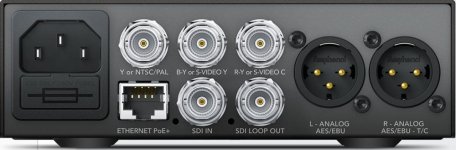

The only unit I'm aware of at the moment that is capable of ripping the TC out SDI is the Teranex Mini from Blackmagic design. It can take in SDI and de-embed the time code and stick it out as LTC from the 'R' audio channel XLR. Not super cheap at $695 but still way cheaper than the CA back. It can also generate 3D LUTs for on set monitoring so has some added benefits. It runs off mains power but could be fed by an inverter on location I guess.
