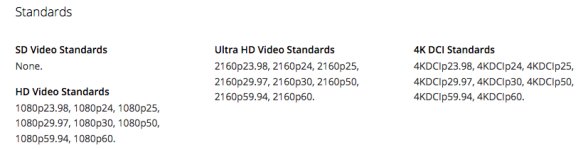

On their PDF, they usually note the shooting resolutions and framerates, and then a second chart a bit below (called "standards") shows what the HDMI and/or SDI can support (in this case HDMI).
I would be very surprised if it was limited to HD...Blackmagic doesn't do that.
Wow, you're totally right:
"The full size HDMI connector supports 10-bit 4:2:2 1080p HD video with support for
HDR and two channels of embedded audio. Use the touchscreen menu to set a clean
feed or include overlays on the output."
I guess it's too much for it to handle 4K.
