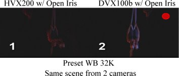

DVX100b Vs HVX 200 : My experience
such is the case with HD cams with 1/3 CCD's.....they are just packed with so many pickles that its harder for light to get through.
Here is my experience:
And this LOW LIGHT issue ...
:P
Control your light
No worries -- of course we knew that. I just love the imagery of the camera being tightly packed with pickles... :thumbsup:

The 100a and 100b do very, very, very well in low light circumstances -- if you're shooting 60i. If you're shooting 24p, they're a stop darker and 6dB noisier. So if you want low light performance, stick to 60i.
The HVX will not match a DVX's sensitivity. In progressive it's a stop slower (needs twice as much light); in interlaced it's two stops slower. That's basically the same story with all the low-cost HD camcorders, they're all 1 to 2 stops slower than their standard-def counterparts.

Progressive 1/3" CCD cameras are not for low light shooting... period. You can make them work with some effort but that is not what they are made for.

The 100B kicks ass. I prefer it to the HVX in many occasions such as: docs, run and gun, shows that work with available light at night, and purely SD broadcast. I own an HVX because that's what everyone wants to rent .
The B is like the way CRT's have gotten just before the onslaught of flat screens. CRT's don't have as many pixels but still deliver a superior picture with more depth, contrast, brightness, etc. There's a reason most DI work is still done on a CRT. But the rub is, everyone wants a flat screen. More pixels they think equals better pic.
I feel the B is the pinnacle of SD capture in a handheld camera. The HVX is far from the best of HD. A year or two from now when all the CRT's are in the Smithsonian, the B will be put out of it's misery.
When Panasonic can solve the noise / lowlight issue with the HVX then it'll really be a step up. They better jump on it. Sony's begining to rumble. I would really love to shoot in Cinelike D one day. I love low con imagery and not having to always crush the blacks. Do that with an HVX in CInelike D with soft light against a slightly darker than medium grey or black background, have your actor move about and you'll see noise like you've never seen with a B. It really takes the Def out of high def.
Wait till you encode to DVD. Now you'll really weep, especially when viewed on a plasma or lcd.
Then I hear all these ad hoc solutions such as shoot on Cinelike V or B Press, bump up the detail coring, and go minus on the pedastal. And just like that, we're back to that look, quasi fight club balony that is now becoming the hallmark of HVX footage.
With the B, I'm not afraid to go low con and bump up the black levels. Noise is not an issue. It's like my Canon Elph that's 6 mpix. It blows away the 10 mpix version in every resepect because there comes a point when a small chip just can't handle too many pixels.
