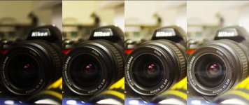

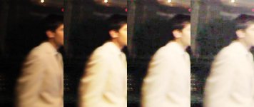

Ok, here is some 5dII material we all loved though some processing. It came from MVI_0492.MOV and was used on Reverie, it's the clips that were pulled from the Canon website. I believe we all accept 5dII has a very good codec for a dSLR. And I hope Vincent will not sue:)
And the same processing applied to an 8-Bit uncompressed image from my camera prototype. DNxHD and high end intraframe formats are not that far in quality. The original was 12bit, but I reduced to 8-bit since that's what the 5dII codec is limited to.
If differences like that were not important, nobody would buy anything more than a $1000 dSLR or a $1000 camcorder.
A professional will notice the motion blur is insanely high, a lot more than what the shutter setting would naturally produce and this blur is added by the codec's inability to track motion and its smoothing filters. This guy's face is not even recognisable until he stops moving at the end of the shot. There is aliasing and filtered blocking over anything that moves, even before the processing is applied.
Examine the 5dII image at 50% size, that's the 540lines high equivalent, the height of PAL SD practically. A PAL DVX would compete well IMHO, and digital beta SD would look FAR better.
And this is a locked shot on a tripod, it makes it easy on the 5dII GOP codec.

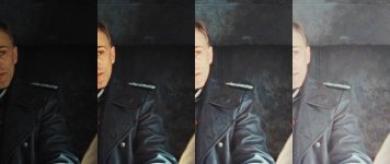

Here is the same processing applied to a bluray frame:
Impressive isn't it? This frame was even compressed to JPG when I started. It could even make good use of uncompressed. Any real-time GOP codec will compromise a bluray, even 50mbit ones. Bluray obviously maintains fine detail at its low datarate, because the codec is of very high quality, not a real-time dSLR codec compromised in every possible way. 5dII does not even have 20% of the image quality a bluray can contain (resolution+texture), perhaps even 10% when heavy motion is present. But it's still good for low resolution online clips or low quality 720p brodcast perhaps.
