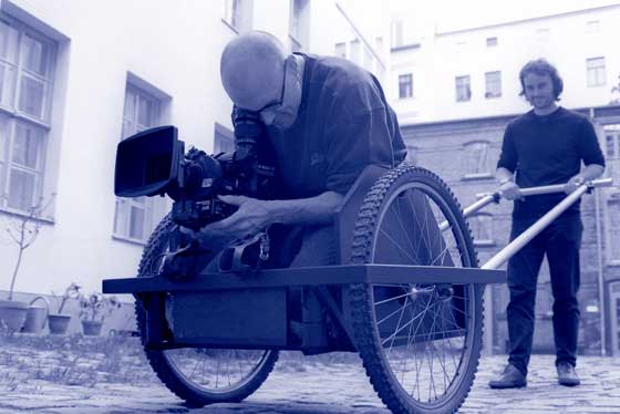

I'm actually loving what they're using there in the image, but even finding something like that is pretty difficult. I've tried using a shopping cart before, but theyre generally ragged and come off shaky (and not in a good way).
I'm not immensely low on budget, but an efficient hardware for the tracking scene is what I'm after.
