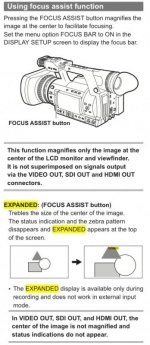

I was confused as well and thought something was wrong because the manual states that it works during recording.
Thanks Barry.
Couldn't find the setting, and for a while I thought I had a defective cam.
Kinda of like to use the focus assist while shooting, but it's a tradeoff.
I saw that as well.
It says:
"EXPANDED: (FOCUS ASSIST button)
Trebles the size of the center of the image. The status indication and the zebra pattern disappears and EXPANDED appears at the top of the screen.
EXPANDED
The EXPANDED display is available only during recording and does not work in external input mode."
Wonder if was taken out.
