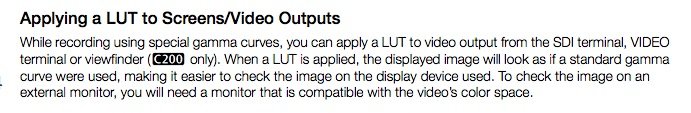

Tough call. For me, if I had the 200B, I would have to buy a Zacuto Gratical which is another $2,300.00 So for me, the stock EVF and using my older, just okay Zacuto EVF Pro is working. The only thing that is frustrating me is that for some reason, I don't think the C200 let's you apply a LUT to the HDMI output, only the EVF, touchscreen and SDI. I have had someone at Canon looking and trying to verfy if that's true but so far, I can't figure out how to apply the BT-709 LUT to my HDMI output. If I had a Gratical Eye or Gratical, wouldn't matter since they can exhibit their own LUTs but the EVF Pro was made for DSLRs so it has no internal LUT capacity. So when I am shooting C-Log 3, shoulder mounted with the EVF Pro, I have to look at and try to judge exposure and focus on a washed out C-Log 3 view. The diagram in the menus shows you able to apply a LUT to all of the other outputs, just not HDMI, which doesn't really make sense to me. If they can apply it to SDI, why not HDMI? Anyway, so it appears that I am SOL unless I swap out the EVF Pro for something that either takes SDI or has it's own built in LUT ability. Makes so sense why they can send it out SDI but not HDMI?
